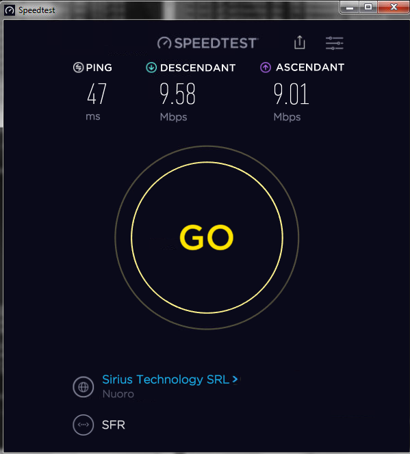

pour le plaisir, d'autres test (PC en direct sur la box I5 - 16Go ram SSD cable 6E):
(ping 8.8.8.8)
50 PING VPN CO
Ping sent: 60, received: 42, loss: 0.30%
Latency average: 251ms, best: 297ms, worst: 805ms
 60 20:24:23 PASS 506ms
 59 20:24:22 PASS 308ms
 58 20:24:21 PASS 335ms
 57 20:24:20 PASS 307ms
 56 20:24:19 PASS 313ms
 55 20:24:18 PASS 357ms
 54 20:24:17 PASS 321ms
 53 20:24:16 PASS 316ms
 52 20:24:15 PASS 305ms
 51 20:24:14 PASS 303ms
 50 20:24:13 PASS 300ms
 49 20:24:12 PASS 303ms
 48 20:24:11 PASS 297ms
 47 20:24:10 PASS 322ms
 46 20:24:09 PASS 304ms
 45 20:24:08 PASS 300ms
 44 20:24:07 FAIL
 43 20:24:06 PASS 348ms
 42 20:24:05 FAIL
 41 20:24:04 FAIL
 40 20:24:03 FAIL
 39 20:24:02 FAIL
 38 20:24:01 FAIL
 37 20:24:00 PASS 304ms
 36 20:23:59 PASS 309ms
 35 20:23:58 PASS 304ms
 34 20:23:57 PASS 350ms
 33 20:23:56 PASS 438ms
 32 20:23:55 PASS 708ms
 31 20:23:54 FAIL
 30 20:23:53 FAIL
 29 20:23:52 PASS 327ms
 28 20:23:51 PASS 805ms
 27 20:23:50 FAIL
 26 20:23:49 PASS 307ms
 25 20:23:48 PASS 308ms
 24 20:23:47 PASS 311ms
 23 20:23:46 PASS 310ms
 22 20:23:45 PASS 309ms
 21 20:23:44 PASS 302ms
 20 20:23:43 PASS 306ms
 19 20:23:42 PASS 323ms
 18 20:23:41 FAIL
 17 20:23:40 FAIL
 16 20:23:39 FAIL
 15 20:23:38 FAIL
 14 20:23:37 FAIL
 13 20:23:36 FAIL
 12 20:23:35 PASS 306ms
 11 20:23:34 PASS 334ms
 10 20:23:33 PASS 595ms
  9 20:23:32 FAIL
  8 20:23:31 PASS 310ms
  7 20:23:30 PASS 327ms
  6 20:23:29 PASS 720ms
  5 20:23:28 FAIL
  4 20:23:27 FAIL
  3 20:23:26 PASS 314ms
  2 20:23:25 PASS 308ms
  1 20:23:24 PASS 309ms
50 PING NO VPN
Ping sent: 60, received: 60, loss: 0.00%
Latency average: 327ms, best: 292ms, worst: 874ms
 60 20:26:01 PASS 304ms
 59 20:26:00 PASS 301ms
 58 20:25:59 PASS 298ms
 57 20:25:58 PASS 322ms
 56 20:25:57 PASS 298ms
 55 20:25:56 PASS 305ms
 54 20:25:55 PASS 300ms
 53 20:25:54 PASS 305ms
 52 20:25:53 PASS 303ms
 51 20:25:52 PASS 307ms
 50 20:25:51 PASS 296ms
 49 20:25:50 PASS 295ms
 48 20:25:49 PASS 295ms
 47 20:25:48 PASS 309ms
 46 20:25:47 PASS 305ms
 45 20:25:46 PASS 299ms
 44 20:25:45 PASS 295ms
 43 20:25:44 PASS 320ms
 42 20:25:43 PASS 299ms
 41 20:25:42 PASS 297ms
 40 20:25:41 PASS 331ms
 39 20:25:40 PASS 303ms
 38 20:25:39 PASS 310ms
 37 20:25:38 PASS 316ms
 36 20:25:37 PASS 330ms
 35 20:25:36 PASS 331ms
 34 20:25:35 PASS 306ms
 33 20:25:34 PASS 311ms
 32 20:25:33 PASS 304ms
 31 20:25:32 PASS 321ms
 30 20:25:31 PASS 381ms
 29 20:25:30 PASS 309ms
 28 20:25:29 PASS 292ms
 27 20:25:28 PASS 363ms
 26 20:25:27 PASS 293ms
 25 20:25:26 PASS 307ms
 24 20:25:25 PASS 295ms
 23 20:25:24 PASS 304ms
 22 20:25:23 PASS 378ms
 21 20:25:22 PASS 300ms
 20 20:25:21 PASS 294ms
 19 20:25:20 PASS 308ms
 18 20:25:19 PASS 341ms
 17 20:25:18 PASS 300ms
 16 20:25:17 PASS 295ms
 15 20:25:16 PASS 298ms
 14 20:25:15 PASS 296ms
 13 20:25:14 PASS 298ms
 12 20:25:13 PASS 297ms
 11 20:25:12 PASS 297ms
 10 20:25:11 PASS 308ms
  9 20:25:10 PASS 308ms
  8 20:25:09 PASS 308ms
  7 20:25:08 PASS 311ms
  6 20:25:07 PASS 299ms
  5 20:25:07 PASS 729ms
  4 20:25:05 PASS 296ms
  3 20:25:04 PASS 293ms
  2 20:25:03 PASS 440ms
  1 20:25:03 PASS 874ms
SPEEDTEST NO VPN : (je suis censé avoir la plus grosse offre fibre)
Information ONT
Haut du formulaire
Lancer
Bas du formulaire
Le Mini boîtier ONT est correctement alimenté.
Le Mini boîtier ONT est synchronisé.
Le software du Mini boîtier ONT est à jour.
Le Mini boitier ONT est correctement raccordé à la Box.
Modèle
I-010G-Q
Version principale
3FE7SW04030009
Version de secours
3FE7SW0401001C
Temps de service
15j 6h 59min. 4sec.
Date de rafraîchissement
Jeudi 18 Avril 2019 18:31:22
Numéro de série
PTIN91701B81
Rangement de l'ONT sur PON
O5
Intensité signal optique reçue (dBm)
-20.18 dBm
Intensité signal optique transmise (dBm)
2.99 dBm
BIAS (mA)
5.71 mA
Température (°C)
35.00 °C
